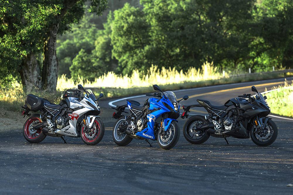

The 2024 Suzuki GSX-8R lineup.
The 2024 Suzuki GSX-8R lineup. (Suzuki/)

The GSX-8R is all-new for 2024, but heavily based on the GSX-8S. The 8R is available in three colors: Metallic Triton Blue, Pearl Ignite Yellow, and Metallic Matte Sword Silver.
The GSX-8R is available for $9,439—just $440 more than the 8S. Other than the obvious exterior differences between the 8S and the 8R, the most significant change is the suspension. The S model uses KYB units front and rear, while the R model harnesses a nonadjustable Showa SFF-BP (Separate Function Fork - Big Piston) fork with 41mm inner tubes and 5.1 inches of travel. At the rear, the 8R uses a preload-adjustable Showa shock. The 8R also ditches the naked bike's one-piece handlebar for bars that mount to the top of the triple clamp.

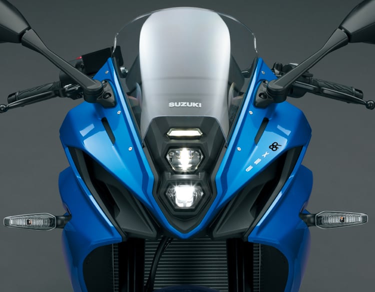

The central LED headlights and fairing intakes share a strong family resemblance with decades of GSX-Rs.
The central LED headlights and fairing intakes share a strong family resemblance with decades of GSX-Rs. (Suzuki/)

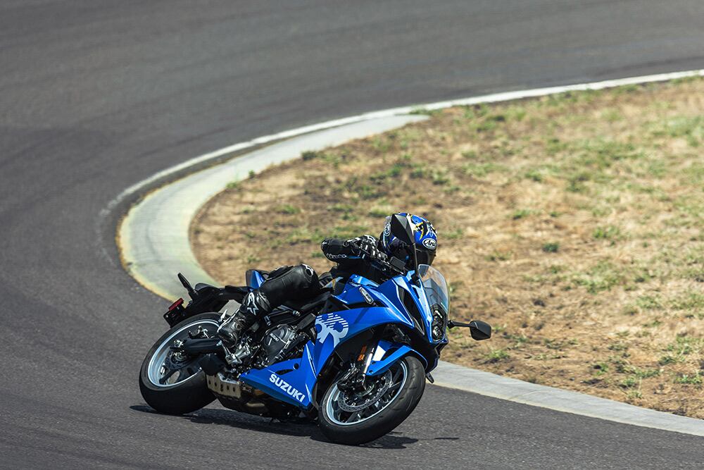

Regular track riders may require higher rearsets to improve cornering clearance, but most road riders will appreciate footpeg placement that maximizes comfort.
Regular track riders may require higher rearsets to improve cornering clearance, but most road riders will appreciate footpeg placement that maximizes comfort. (Suzuki/)
Chassis and Handling
The GSX-8R's chassis is nearly identical to the GSX-8S naked bike, but uses higher-spec suspension. While the 8S wears KYB units front and rear, the R model uses a nonadjustable Showa SFF-BP (Separate Function Fork - Big Piston) fork with 41mm inner tubes and a preload-adjustable Showa monoshock in the rear.
On the road, the setup, which is far more basic than what 600 supersports use, still provides consistent damping that handles bumps well while being firm enough to keep the bike from blowing through the suspension travel when the rider is pushing on. Handling is light and predictable with good communication from the front end, like you'd expect from Suzuki. Despite weighing in at a relatively heavy 452 pounds (the Yamaha YZF-R7 is 414 pounds and the GSX-R600 is 412 pounds), the 8R is well balanced and hides its weight. It remains responsive midway through corners, and remains super stable just about everywhere, which boosts confidence on the street and track. It may not be as natural a trackday companion as a GSX-R, but the thing will do it—and for a lot less than a Gixxer.

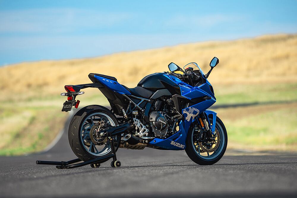

The license plate bracket carries the taillight so it will be difficult to add a tail tidy to clean up the rear end of the bike.
The license plate bracket carries the taillight so it will be difficult to add a tail tidy to clean up the rear end of the bike. (Suzuki/)

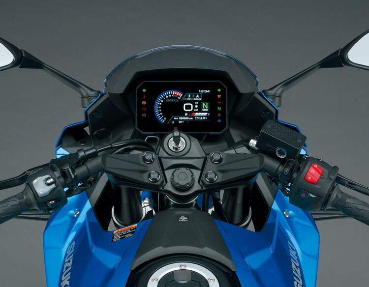

The cockpit is pleasantly sparse.
The cockpit is pleasantly sparse. (Suzuki/)
Ergonomics: Comfort and Utility
Suzuki spent its time developing the 8R's aerodynamic fairing in the wind tunnel and it shows. On the racetrack, tucked behind the bubble, the rider's helmet isn't buffeted by unwanted turbulence, even at triple-digit speeds. On the street, the rider is protected by a pocket of clean air that lets the rider enjoy the supersmooth engine.
Unlike full-on sportbikes, the 8R's ergos are humane and relaxed. Instead of a sportbike's low
clip-ons, the 8R's handlebars mount to the top of the triple clamp, so even around town when there's not enough wind to support the rider's torso, they can still feel at ease because of the far more upright position. While the riding position is more leaned over than the 8S, it's by no means Gixxer-like. Plus, the footpeg position is identical to the 8S, which is, well, a naked bike. If a GSX-R has the legroom of a cheap economy seat, the 8S and 8R give you room to stretch out, exit row-style.

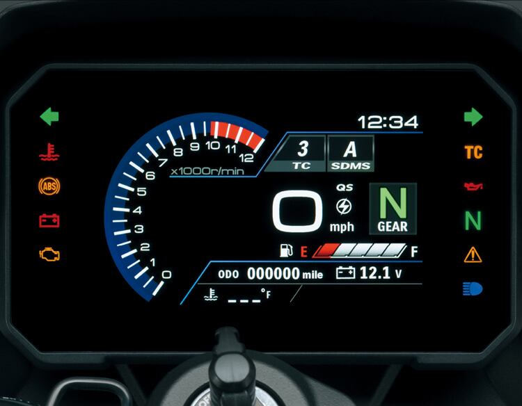

The TFT dash makes it easy to change ride modes.
The TFT dash makes it easy to change ride modes. (Suzuki/)
Electronics
The GSX-8R has three ride modes that adjust throttle response and power delivery, and four-level traction control. ABS and a bidirectional quickshifter come standard. Ride modes aren't lean-angle-sensitive, which is appropriate in this category. The 5-inch TFT dash is intuitive to use. It's also equipped with LED lighting. Additional features include Suzuki's Easy Start System and Low RPM Assist System, which increases engine speed to smooth the power delivery when leaving from a standing start or riding at low speeds.
