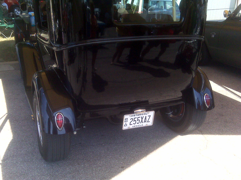

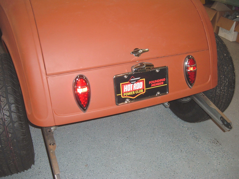

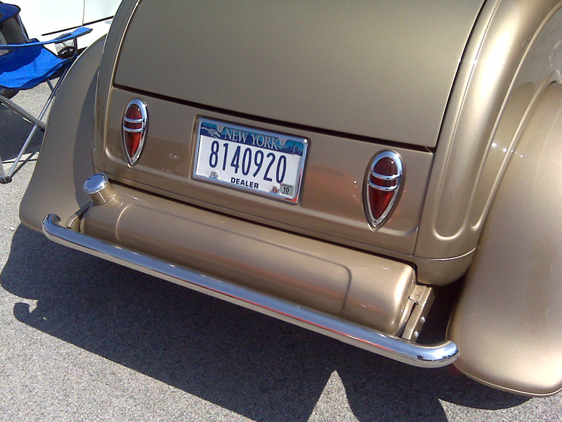

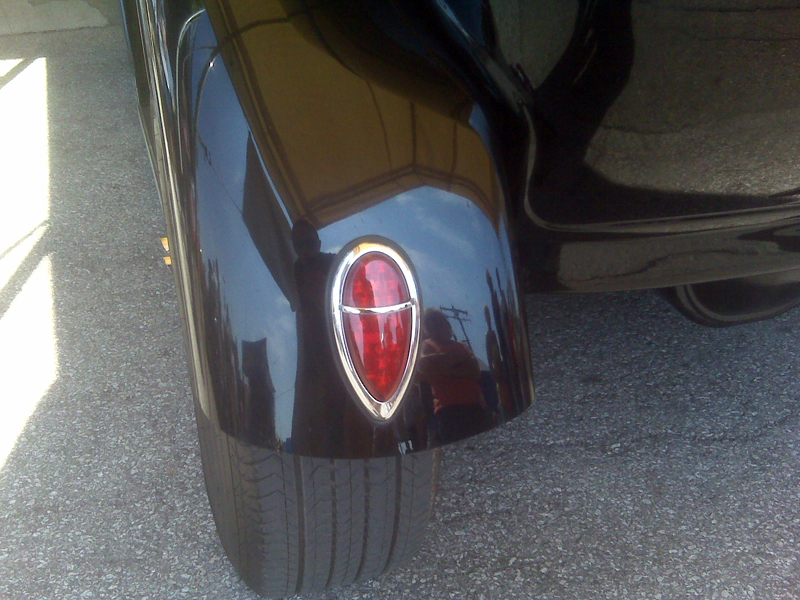

Quote from: Troll on April 03, 2015, 12:46:32 PM
How about something like this?: http://www.ebay.com/itm/Vintage-Style-1939-FORD-LED-Signiture-Series-Tail-Lights-COOL-CUSTOM/151609573471?_trksid=p2047675.c100005.m1851&_trkparms=aid%3D222007%26algo%3DSIC.MBE%26ao%3D1%26asc%3D28790%26meid%3D0f08f82b688f4e52a4ebfbca177eb383%26pid%3D100005%26rk%3D1%26rkt%3D6%26mehot%3Dlo%26sd%3D201300879682&rt=nc
Very cool!  That's definitely the vibe I'm going for.   8)
I also saw these Lincoln Zephyr lights sold by the same seller.  The lights above have 14 LEDs and the Zephyr lights have 21 LEDs.  Would the latter be too much current draw, or would it be okay?
