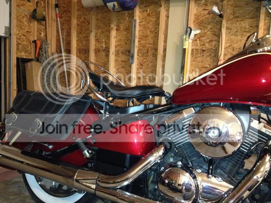

jmbo
The attached photo shows the springer seat setup for my 1500. Not sure how the 800 differs as far as the lower frame mounts.  The seat is mounted well behind and well below the height of the tank. The seat is extremely comfortable and because the seat is set further back than the stock seat, I have much more leg room. The springs are a MUST. The seat has zero padding.  The springs make up for that. The springs get quite a workout especially on a bumpy road. in extreme situations between the seat going down and the fender coming up the seat nearly bottoms out.  That is how much the springs compress to take up the road shock.

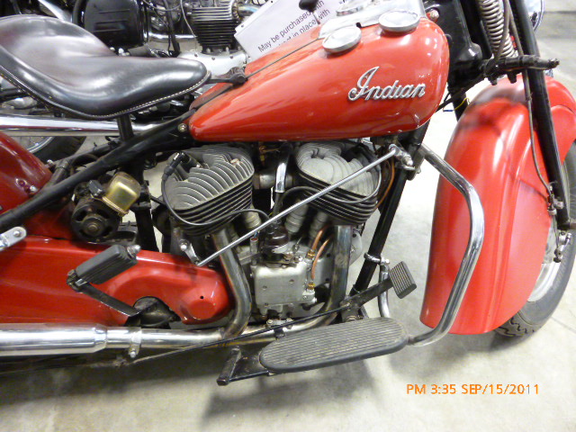

I made a similar springer solo seat and the problem was the rail, not the seat pan itself. This kind of seat was used in the past on the rigid frame or plunger-type rear suspension and they were also more in front of the bike positioned - the first front 1/3 of the seat was above the rear end of the gas tank. Also, the position of the rider was aparently more higher because the tank was lower - the backbone of the frame was up between the semi-tanks and the seat support was hinged from it. Probably the solution found by that indian saddle maker os the best for VN 800.
  I like the whole idea, but I think it should be pretty easy to find a spring and even if you have to cut it to fit, but I am sure you can figure it out, but it would look so much better.

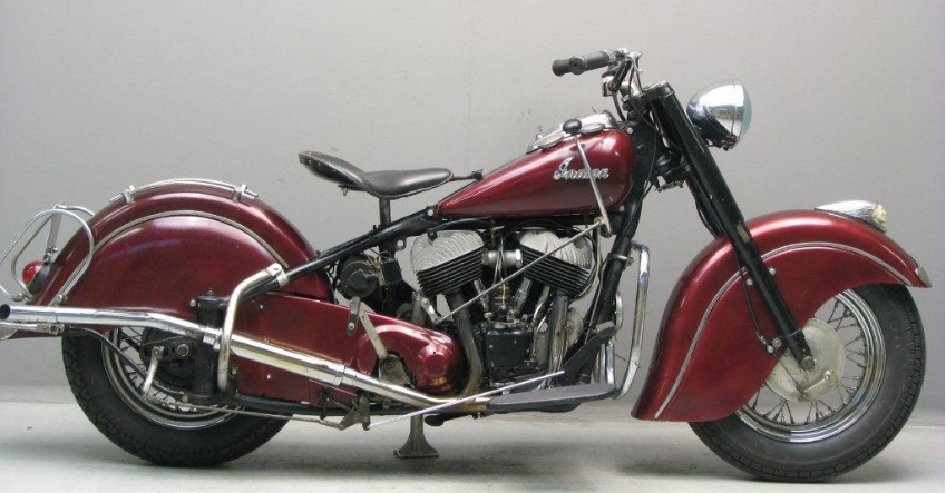

Thanks for the comments. I was kind of thinking of images like these when I decided to go with a rigid seat.

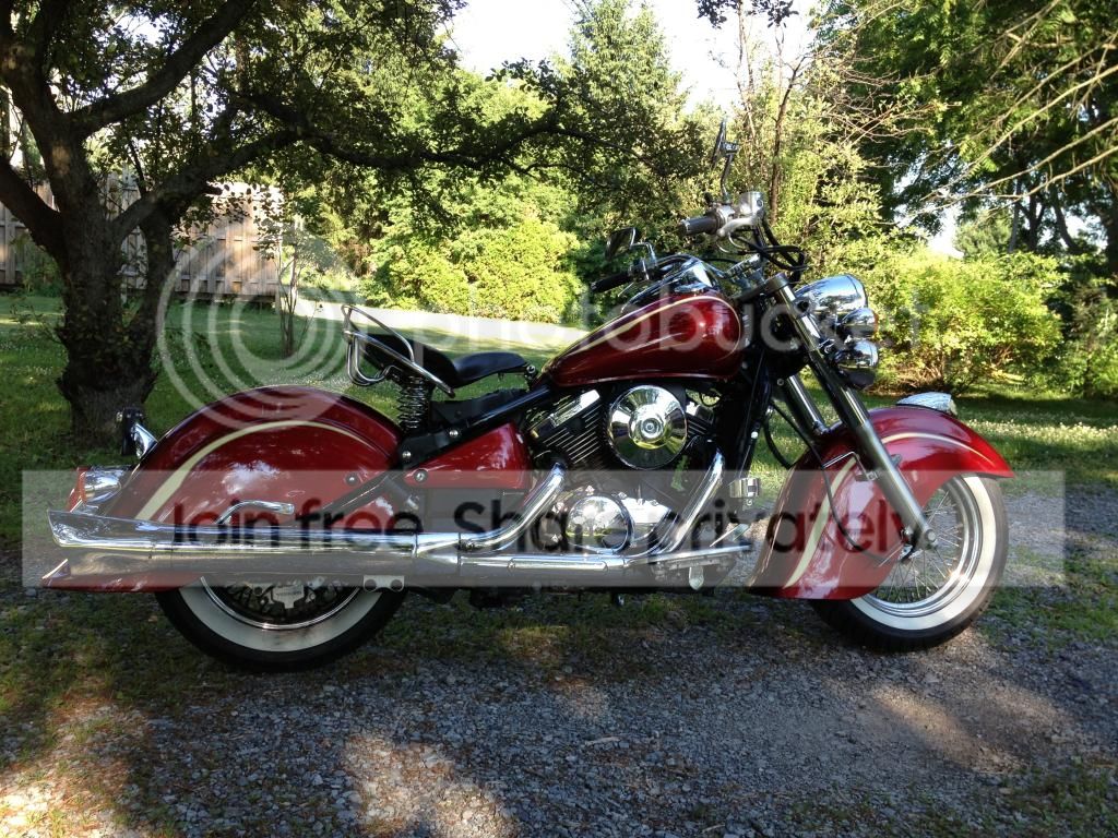

I'll have to agree with Ratman on this . Not only by adding springs to the seat for a smoother ride it also adds class in my own opinion , of course . Me personally , I would try to move the seat closer to the tank as well for a cleaner look . Here's a picture of my set up if you need a reference to help out .

We figured it out and got it modified to work in the "real world". We lost the springs in the process, but I can add some faux springs if I feel like it. Here are some photos:
The previous mounting bracket was in two places at an angle to clear the rear fender as it moves up and down. Pieces of one inch steel stock were welded to join the bracket halves with the seat frame. They were tacked while the frame was on the bike to make sure that the angles were correct.

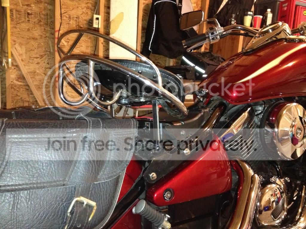

Here are a few photos of the current springer seat mount that is creating problems:
It is pretty easy to identify the problem. Now....the solution may be more interesting!  As you can see, the seat is quite wide and long. I think that mounts can be made that will fit seat frame directly over the second bolt on the bike frame mount. I may end up losing the springs to make this really functional. That is no big deal for me.
I am going to spend Friday morning with a man who will be able to either modify the current mounts or create new ones that will work. He is also going to work on some modifications for the two-up seat to mount a Corbin back-rest and create a tail rack to use with the two-up seat.

I have a similar problem in my 1500 springer seat.  I noticed a chip in my new paint on the top of my fender.  There was a bolt on the bottom of the seat. I am guessing it was for a seat rail.  It stuck down just enough to nick the fender after hitting a hellacious bump. Took the bolt out and so far all seems OK.  However the seat came with two different length springs. In the end I may have to install the longer set. One thing I found on the Drifters is that the wheel/fender travel is much more than you find in any specifications.
