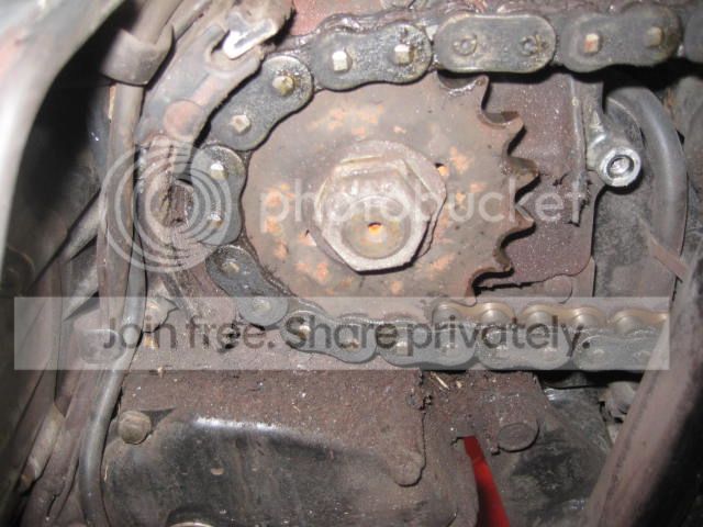

Actually that doesn't look too bad, not too much wear on the chain or the sprocket..
Why not remove the chain and clean it properly, leave it soaking in some kerosine overnight, then dry it and while it is soaking clean all the dirt from the track area and behind the sprocket..then lubricate the chain and refit it..
I think you have quite a bit of life left in that...by the time you need to replace the chain you will probably need a new sprocket as well.
John.

I put the bike up on the lift today. Once I pulled the drive sprocket cover off you could see some problems.
This picture is AFTER I scraped out the crud below.
After I looked closer at the connecting link I could see a rusty spot in the pivot area:
I've put a little over 8K miles on the chain that's on it. I think a combination of crud build up, chain wear and my poor maintenance crated a bad situation.
Anybody have a chain they recommend?
