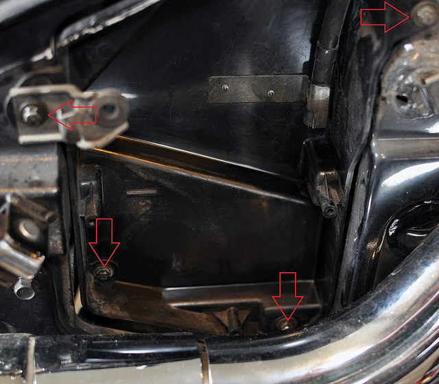

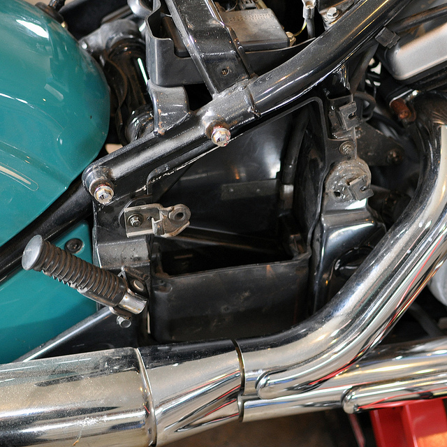

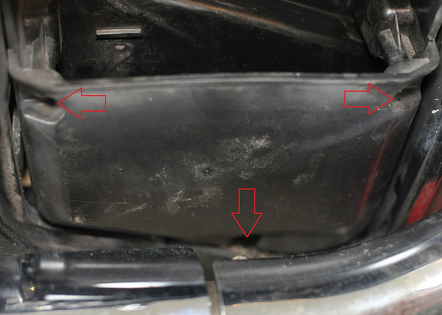

3) Remove the 3 screws that hold the front half of the storage box
4) Remove the 4 bolts that attach the storage box to the frame.

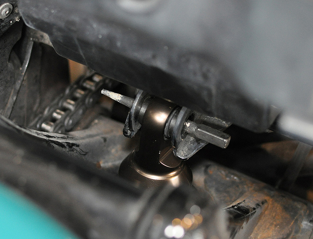

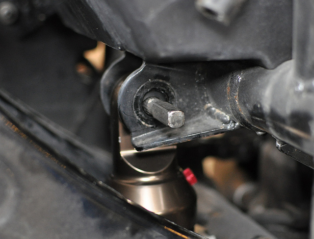

6) Remove the lower shock bolt
7) Remove the upper shock bolt
8) Remove the shock

10) Install upper shock bolt and torque to 43ft-lbs. Because it's a tight space I found it easier to lift the shock into place and use nail set or smaller bolt to hold it in place. Then insert the correct bolt when backing out the temporary.
11) Install lower shock bolt and torque to 43ft-lbs
12) Lower or raise the bike until the Tie-Rod holes line up and then insert the bolt and torque to 43ft-lbs
I installed a Progressive 465 series rear shock. Adjusting preload looks almost impossible while the shock is on the bike so I hope I guessed correctly otherwise. Looks like I may need to remove the shock to adjust the preload. Is there an easy way to adjust preload that I haven't found?
