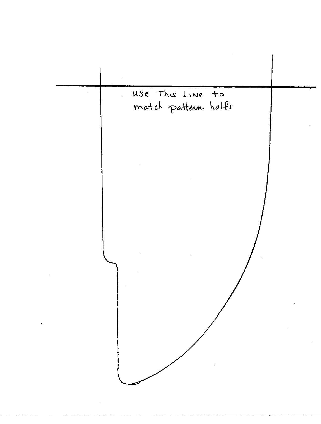

They are made from LEXAN which is a trade name for polycarbonate. Buy 3/16 or ΒΌ inch thick clear. Usually you can get a scrap piece for around $10.00. Leave the protective paper on until you are completely finished and you won't scratch them. Trace the pattern and cut the Lexan with a band saw, jig saw or hand held coping saw. The stuff is incredibly strong and almost unbreakable. The use it for bullet proof applications. Sand by hand or with a belt sander or use a file to smooth up and round up shape. If you want you can then buff edges with tripoli or similar buffing compound . This will produce a real professional looking edge. Depending on the type and location of your turn signals you might have to alter shape as shown on the pattern with the extra curved line.
