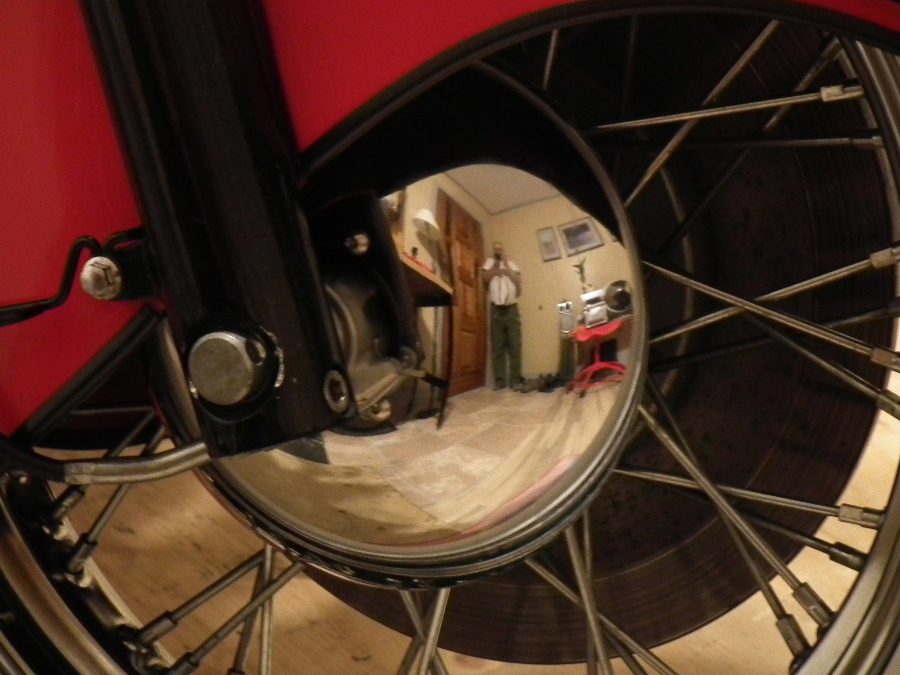

Bike without hub cover installed |

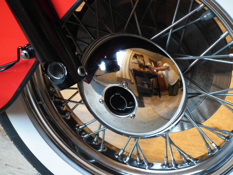

This is the hub cover from the outside and you can see the three screws that will hold the hub cover in place., If you buy your own screws make sure that the heads are as flat as you can get them as there is not much space when the wheel is turning and you can cause some damage to the speedo hub. |

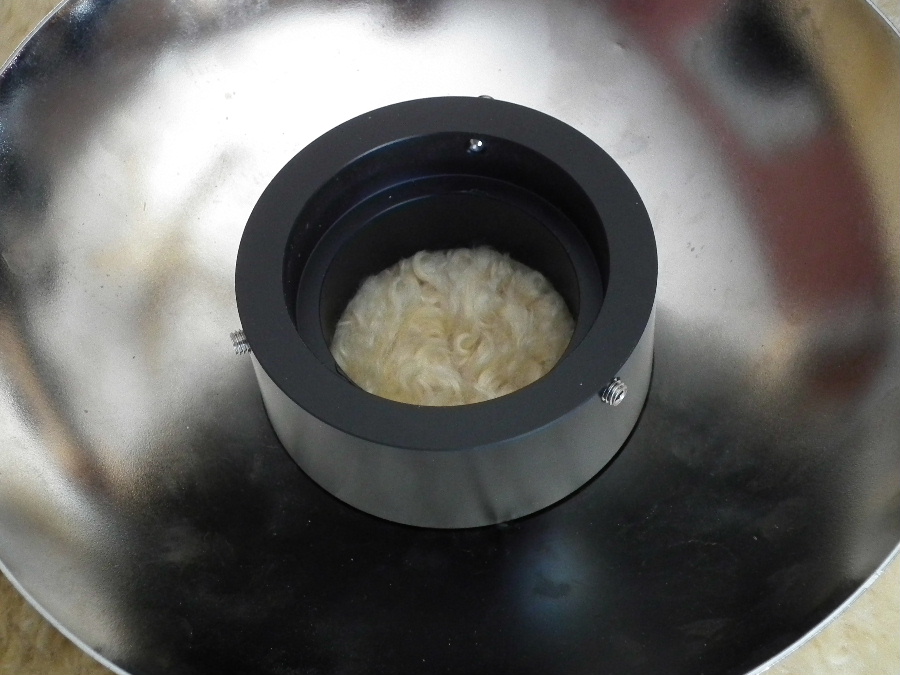

This picture is the hub cover from the inside and you can see the three grub screws that will hold the whole unit to the wheel hub. I used blue thread lock on these screws. |

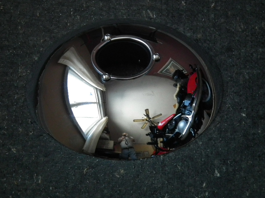

Hub cover connector in place on the front hub and being secured with the grub screws on the hub. |

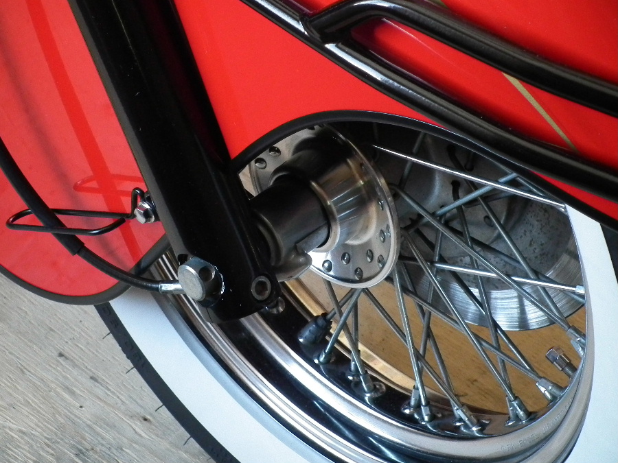

The front hub connecter secured and in place. You can also see the three screw holes to mount the actual hub cover in place. |
Sixth picture shows the setup just prior to the axel being set in place and you see the screws holding the cover in place and again I used blue thread lock to secure the screws. The hub cover should set up tight to the spokes. |

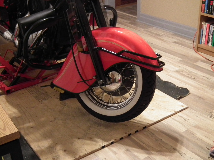

The Seventh picture shows everything back in place, at this time a good idea is to use a lift and get the front tire off the ground, and slowly spin the tire to ensure that the cover screws do not hit the speedo drive nose. If you look lose in the last 2 pictures you will see a really cool person (CDNratman!) taking the pictures…lol. |
This is the completed wheel at a distance and you can see the nice finished look the hub cover gives the Drifter front end. |
