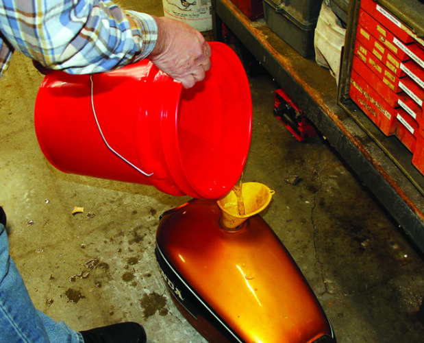

PB Blaster makes a concentrated de-ruster, you mix it with water to create the quantity of cleaner you need. If you have a suitable container, you can re-use the mix until it stops working, at which time you can pour it down the drain as it's not a hazard to the sewer treatment system.
dormant-honda-cb175-5
Once you've got the quantity you need for the job, fill the tank to the brim and let it sit overnight, at least. The time needed for it to work depends on the level of tank rust. Ours was surface rust, so overnight was enough to completely clean the tank.
dormant-honda-cb175-6
The overnight results: Clean metal ready to be used as a gas tank once again. Tanks with worse rust will take longer but eventually produce the same results.
