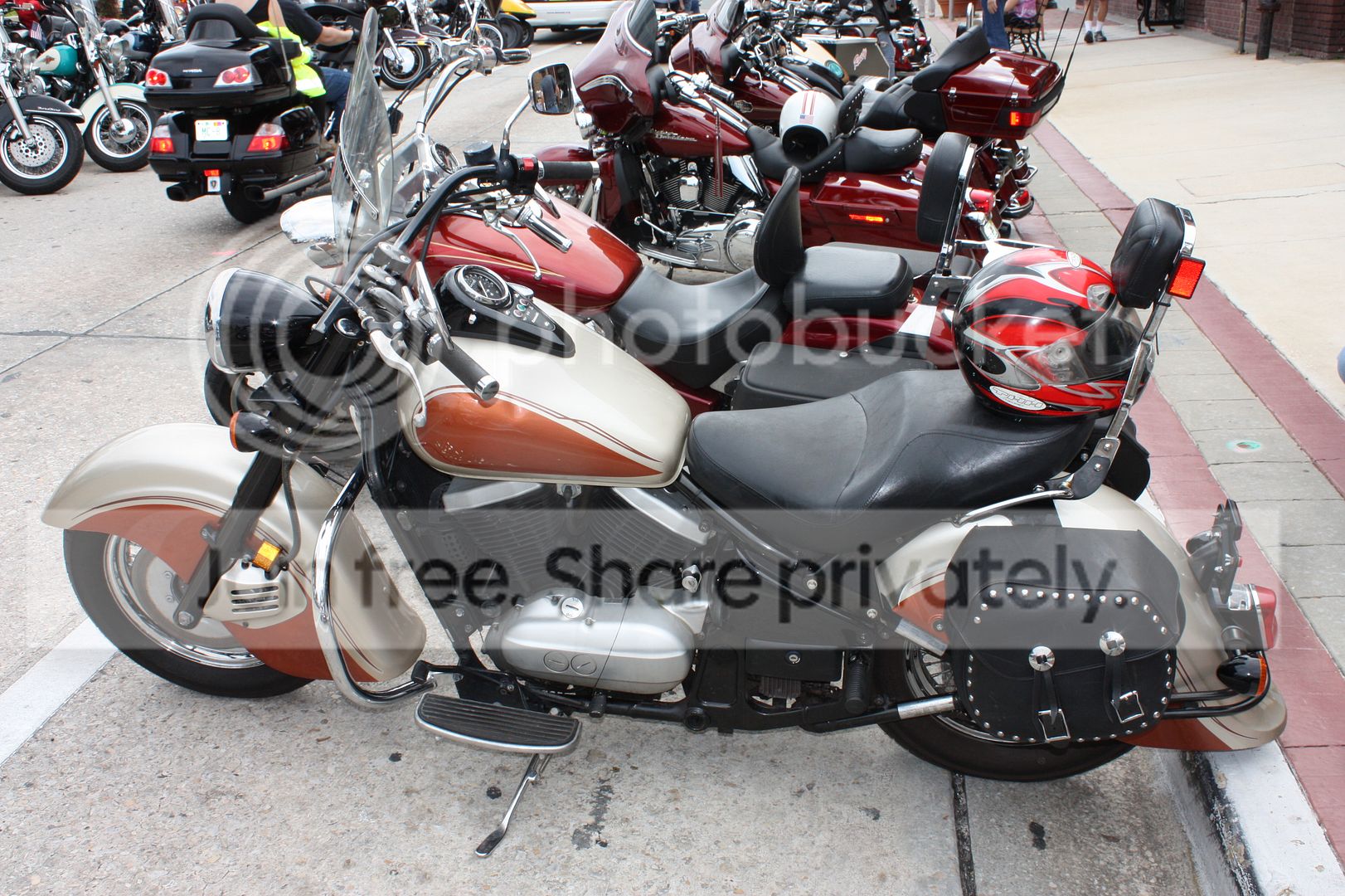

The previous owner of my Drifter had mounted the Indian light on top of the front fender and then moved it lower where it is supposed to be, so now I have two holes in the fender to do something with. So my question is, has anyone else had that problem and decided to cover them up instead of replacing the fender or Bondo? If so I would like to see pictures of the creative ways you covered them up.
