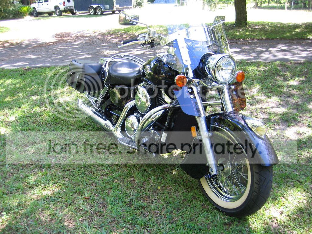

I know there is a difference between 800's and 1500 handling but I had a bit of buffeting and helmet lift till I found I had to lower the wind screen a bit so that I was sitting on it and my eyes were just clearing the top of the screen and not looking through it, it might take a bit of adjustment and patience to find the correct spot for yourself.

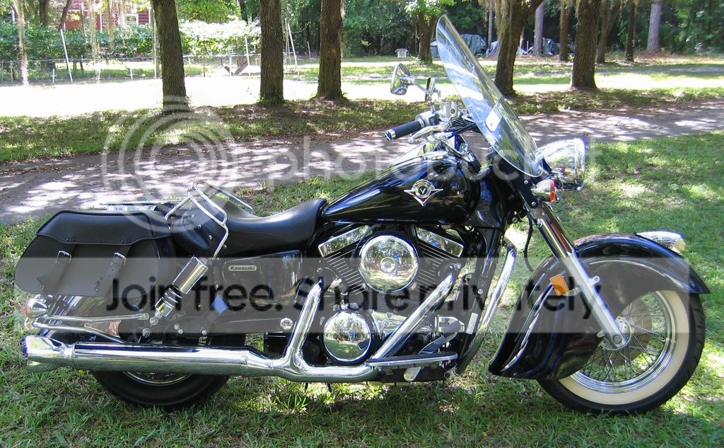

49 is correct on the Roadhouse and that is a Cadillac tip on it that you have.
I hadn't tried lowering it to reduce turbulance - but you bet I will. Now that you've mentioned the muffler tip, Cadillac is a good name for the bike - but I bet that's already been used.

Wind and buffeting is a peculiar thing. What seems to work to reduce buffeting sometimes doesn't and some windshields are better than others, even though of about equal size but slightly different shape. You don't need lowers on your bike but nearly everyone says they are almost a necessity. The buffeting I'm experiencing is bad and has to be solved one way or another. I'm willing to try just about anything.

Welcome aboard. Nice looking bike. You were fortunate to find a bike with the much sought after seat rail and Roadhouse exhaust; both are extinct and very hard to find. As to the buffeting, I run a Chrome Specialtys windshield,no lowers, it came on my Drfter; I had to shorten it as it was too tall, but no buffeting. The only time I had a buffeting issue was when I put my chaps in the gap between the bars and windshield. Then it did a lot of buffeting.
Reo, you just answered one of my questions. I had no idea what that exhaust was. I see it is hard mounted and wanted to do a rubber mount mod since there is a little vibration, and isolating the pipes may help.
I couldn't locate Chrome Specialties to see their shields - instead looked at your bike. Beautiful paint design and setup btw. Too late anyway as I already have a replacement (different design) coming from 7Jurock.

The windshield is a JUROCK Standard screen. I contacted them and requested a Vintage shield drilled to fit onto standard hardware. They said that is possible and are sending drawings for approval. I viewed the Cee Bailey's website and it appears their Drifter shields are identical replacements to the JUROCK and are a bit less expensive, but I had already contacted the Jurock folks.

On your buffeting issue, let me save you a lot of trouble.  Changing windshields will probably not solve your problem.  I know, because I had the same issue, and I tried all sorts of things to get rid of it.  The problem is not the air coming around the shield.  The problem is air coming up along side of the tank.  To cure it, lowers are the ticket.  Give this a read and see if it doesn't help: http://www.vulcandrifterriders.com/forum/index.php?topic=22935.0
i have a similar set of lower on my bike. Makes a huge difference. Without them I get a ton of helmet lift. Other than that I have very little problem with wind buffeting. Also I noticed your windshield seems to be rounded at both the top and bottom ( maybe it's just the phot angle) that might contribute to the problem

On order are 4.5" risers with 1.5" pullback. Bike has lowers but they're too small, so if I can find some thicker acrylic, I'll build a larger set. Also ordering a backrest that can be adapted to the seat rail, and better saddlebags. Previous owner added night LEDs to illuminate the engine, pipes, etc. which look good, but some are in the way for lifting the bike, and I don't like all the excess wiring - it's all over the place - removing and giving to another forum member.

Yeah, that shield looks like the Nomad style shield I have too.  It's a good shield, but if you need something slightly different height or tint, Cee Baileys ( http://www.ceebaileys.com/kawasaki/drifterws.html ) can help you out with that.  I'd look into making some lowers first though.  You wouldn't believe the difference those make!
Very clean looking and nice machine, your wind screen from that angle looks like mine, so I am sure once you get the height thing sorted out the buffeting will be gone.

  This is the first bike I have had with a windscreen, and once I figured out the right height the screen was supposed to be at, and of course I have an 800 so no were near as fast or as much torque as those monster 1500's so that could be the issue, but adding lowers and having the screen at the right height makes a world of difference.

Thank you all for your information on my 02 1500 Drifter. I see from the history chart that it has been repainted, but the new all black paint was professionally done and looks nice. As far as the buffeting issue, the bike already has lowers installed and I was actually quite surprised with the amount of helmet shake. I'm actually looking through the windshield, about 4" below the top edge, so I figured it must be the shape of the screen. It has a very pronounced round shape, and the buffeting is so bad that I can't see anything above around 55 mph. Possibly a little wider windshield, less rounded at the top would be better. I will get it sorted out.
