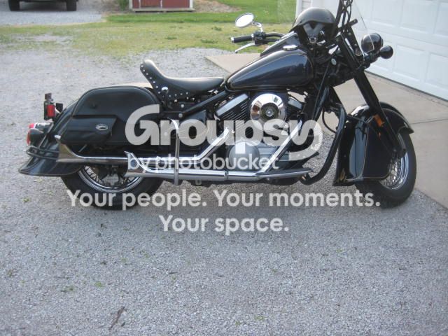

Here's my current "Rev B" saddle bag mounts:

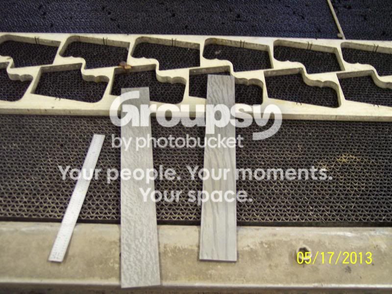

I did some test layouts until I found a location that the bags did not contact the pipes or the seat. I tend to over-build things & this project is no exception. I made the main plates out of 13 gauge (.090") CRS:

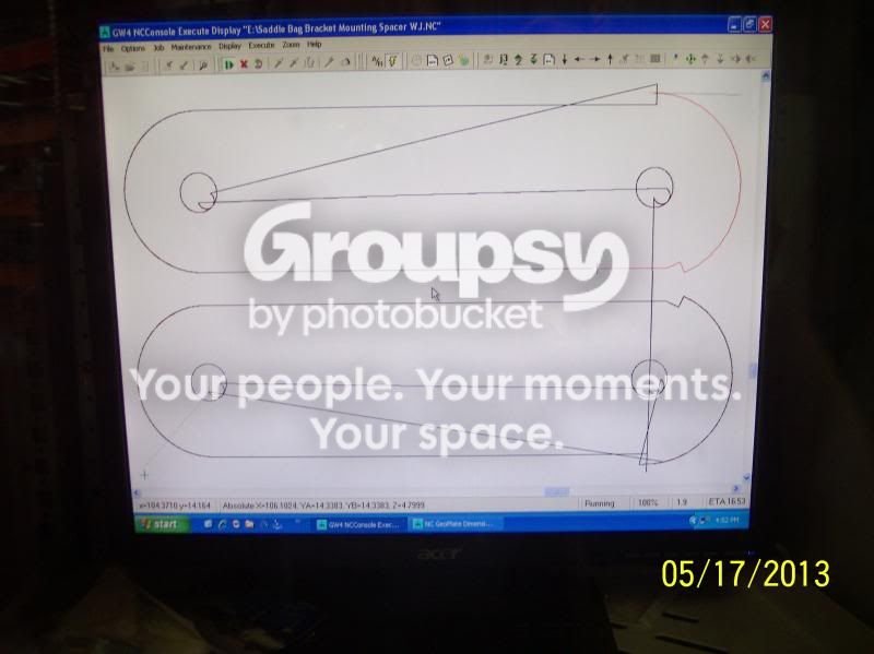

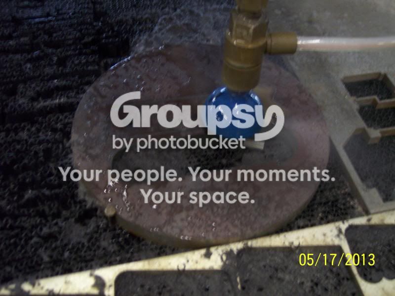

I knew I needed to space them out similar to the stock 2 up seat bracket so I found a hunk of 3/4" A36. It's handy to have access to a waterjet cutter...
Yeah, I know, maybe a little heavy.

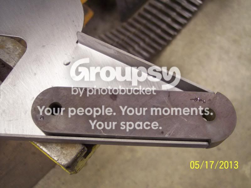

These parts filled the void at the front of the brackets as well as spaced the brackets out.

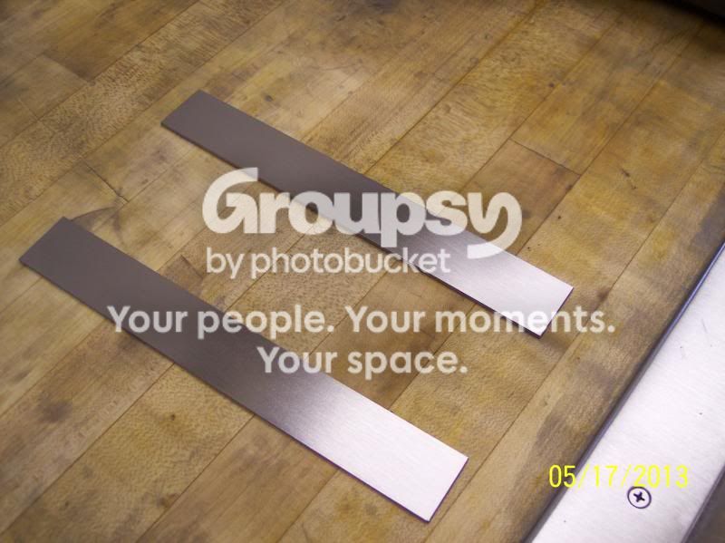

I also wanted something to stiffen the bracket along the length of it so I made a small angle brace out of 13 ga CRS.

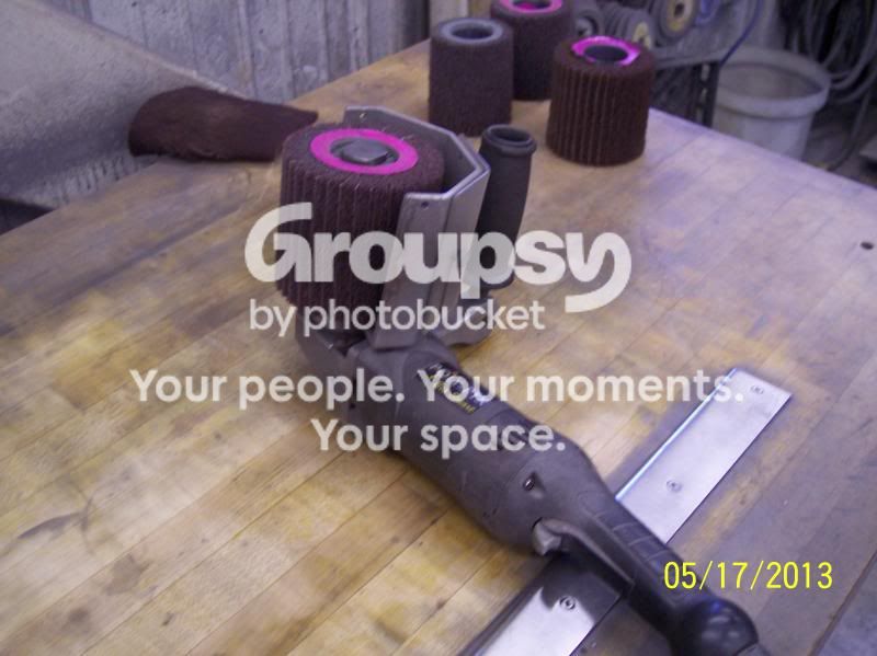

A handy PTX tool cleans up the steel after it's been cut on the WJ

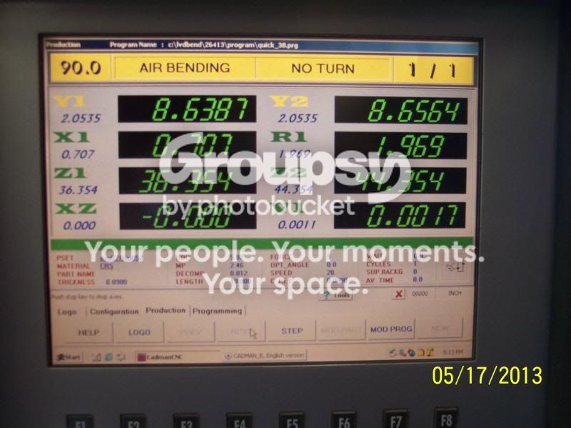

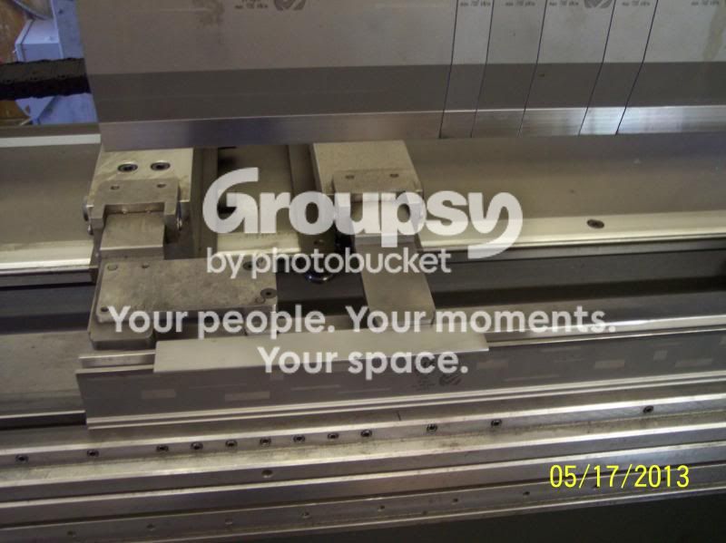

Entered the info in the press/brake:

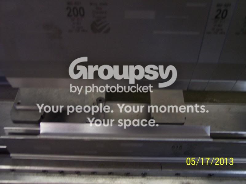

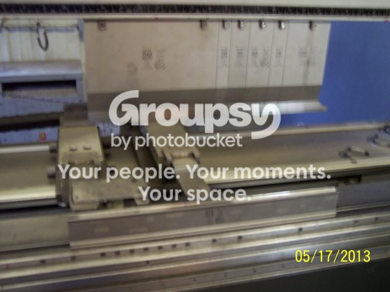

Put in some tooling:

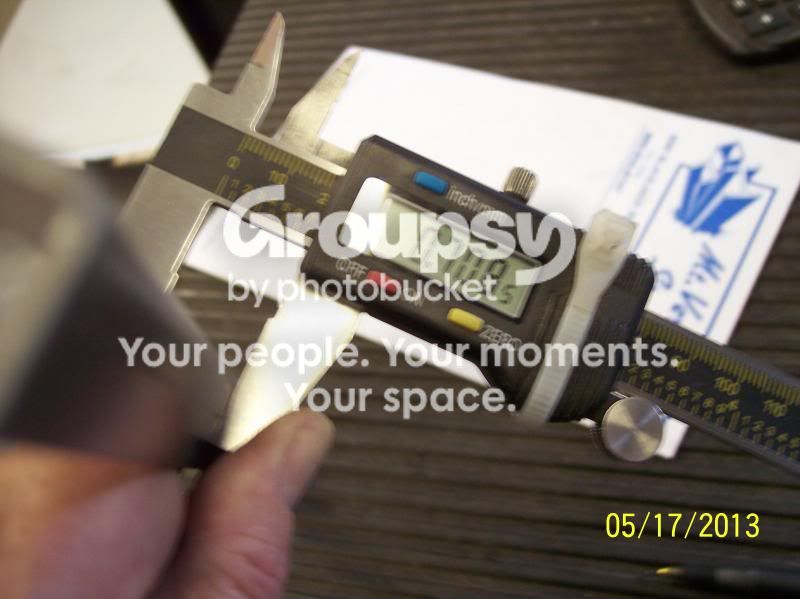

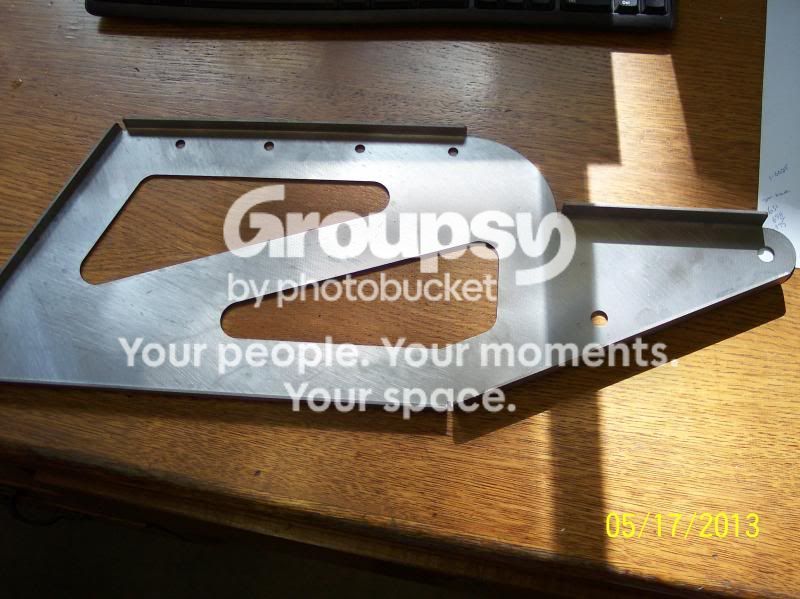

Checked to find out I got lucky the first time

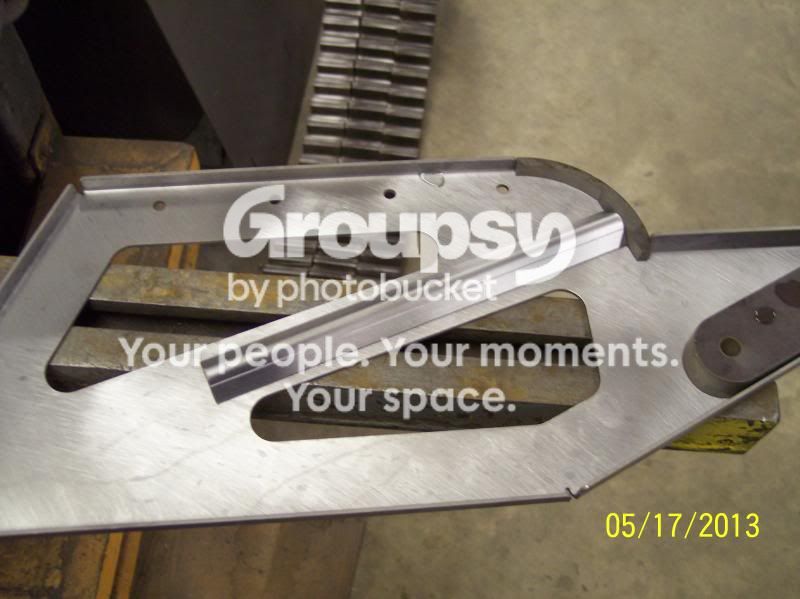

I cut another part out for the radius on top & fit the various parts together
I went ahead and welded them up & ground them smooth. I'm way better with a grinder than I am with a welder.

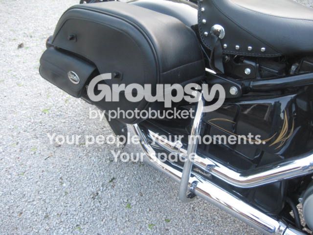

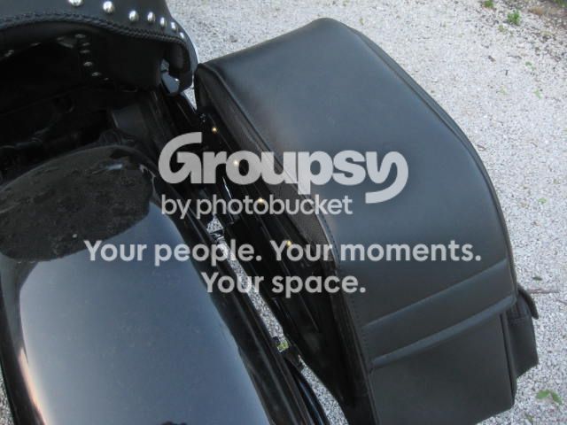

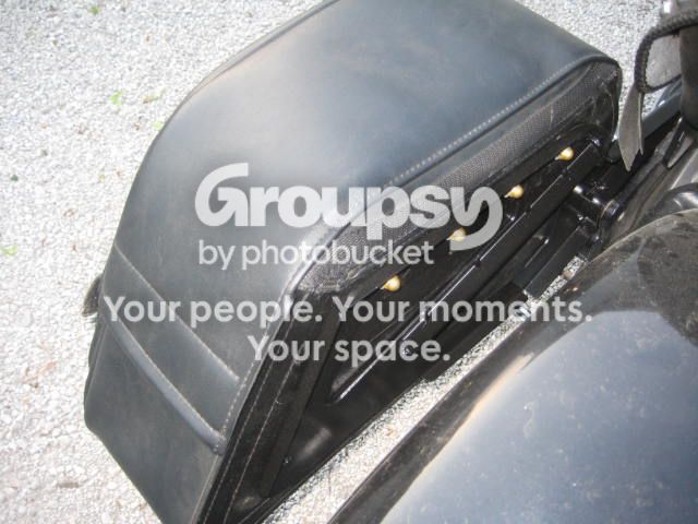

Here they are painted & mounted on the bike. The bike is dirty & in desperate need of a bath.
This picture really bugs me. Does a problem show up in the picture?
Now that I have them on I see a whole lot of things I should have done differently. "Rev B" is in the thought process at the moment.
