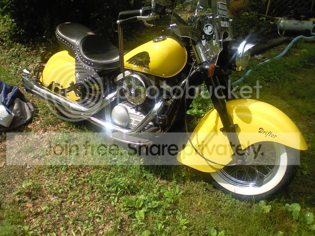

 I having an issue with my bike and was hoping someone might have an idea whats causing it. The bike starts up and runs fine I can drive it anywhere and it seems to do fine. However after it has warmed up and been ridden 10-15 miles it will not restart for 10-20 mins. Omce it has cooled down it will fire back up and run great. It doesn't quit, just wont restart after turning it off after its been ridden. I was at 1st thinking carbs, then got the idea of coils, not sure and would apprecaiate any imput from the fellow riders here. Love my bike, Its named Ole Yeller.
