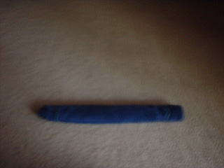

I have a scrap piece of plywood, 3/4" Th. x 1 & 5/8" W. x 18 & 1/2" Lg., I'm sure something close to that size would do but I would have about that length and strong enough to hold the tank with fuel.
Take an old hand towel or half a polishing towel and wrap the board in it, Throw on a couple rubber bands to keep the towel in place. (Fig 1 and 2.)
Figure 1Figure 2
