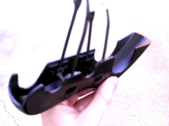

Place 4 mounts inside each bumper. There is some very minor trimming required to make them fit. Takes about 2 minutes to do. Add a drop of glue to the back of each if you're concerned about the mount adhesive coming loose.
Next, press in your Chrysler trim retainers. No mod required. They are ribbed and hold themselves in. No inner nut is required. These simply cover up the two holes in each bumper nicely.
Weather Strip Retainers - Chrysler
Now take your zip ties and loop them through the mounts. See the pic below for how it looks.
Bumpers and wire ties

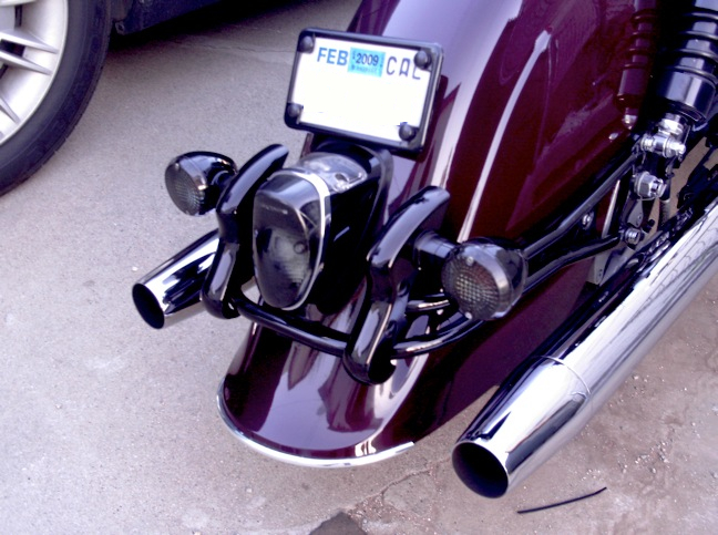

Take your bumpers, put 'em on the fender stay, fasten the ties nice and snug so they don't rattle around and trim the ends.
Installed bumpers
Done. Amaze your friends with your ingenuity. The great thing is that absolutely no permanent alteration is needed to get this done.
